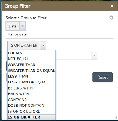

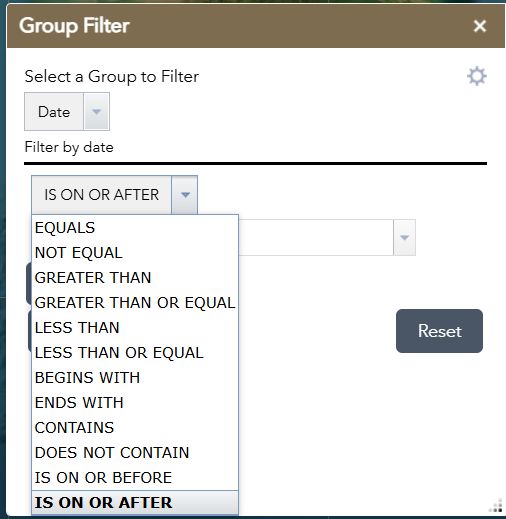

This is a serious limitation unless I am missing something. The WAB version allowed the user to select a Filter type, or operator, from a dropdown menu which is essential for filtering by date(s). I can't find a way to configure this in the EB version, so hopefully I am just overlooking something.

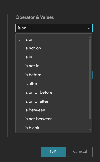

In the Expression Builder, it is only possible to select a single operator for each Group Filter, which means I need to create a new filter for each operator type which means I would need to create up to 12 filters for a single field?
