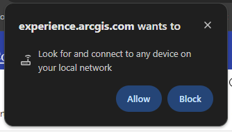

Recently, in the last week or so we now get this little prompt from Chrome while opening an Experience on our Network:
Fortunatly I'm not seeing this prompt off-network, i.e when I open one of my ExB's on my phone....

So it turns out that the access prompt is a new feature in Chrome:
https://developer.chrome.com/blog/local-network-access
Because our Online webmaps that populate our instant apps and experiences are consuming layers from our Hosted Enterprise Site by-reference collaboration, the calls to the layers in said webmaps are causing Chrome to throw up the Access Prompt that I show in my earlier screen grab.
If the on-network user clicks 'no', the apps still work but throw CORS errors in the console.  If the on-network user clicks 'Allow', no errors....
Who knew?  Not great but what can you do?
