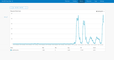

Here is an ArcGIS Monitor Chart showing the number of failed requests for our ArcGIS Server Host Site from 10/13/2025 - 10/27/2025:
Note there are essentially zero failed requests to the entire site prior to the 10/22/2025 ArcGIS Online update.  We changed nothing about our hosting site or our hosted feature layers (or servers, nor have we applied any patches to the 11.5 environment - everything is fully patched for 11.5 prior to the Online update).
This has to be related to the Online update and how the layers are collaborated across from our portal to ArcGIS Online by reference.
But again, there appear to be zero problems with the site, the hosted layers, the collaborations or anything with the servers themselves, e.g. memory use or network.
Everything is working as expected.
I wouldn't even care except it's filling my logs
