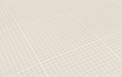

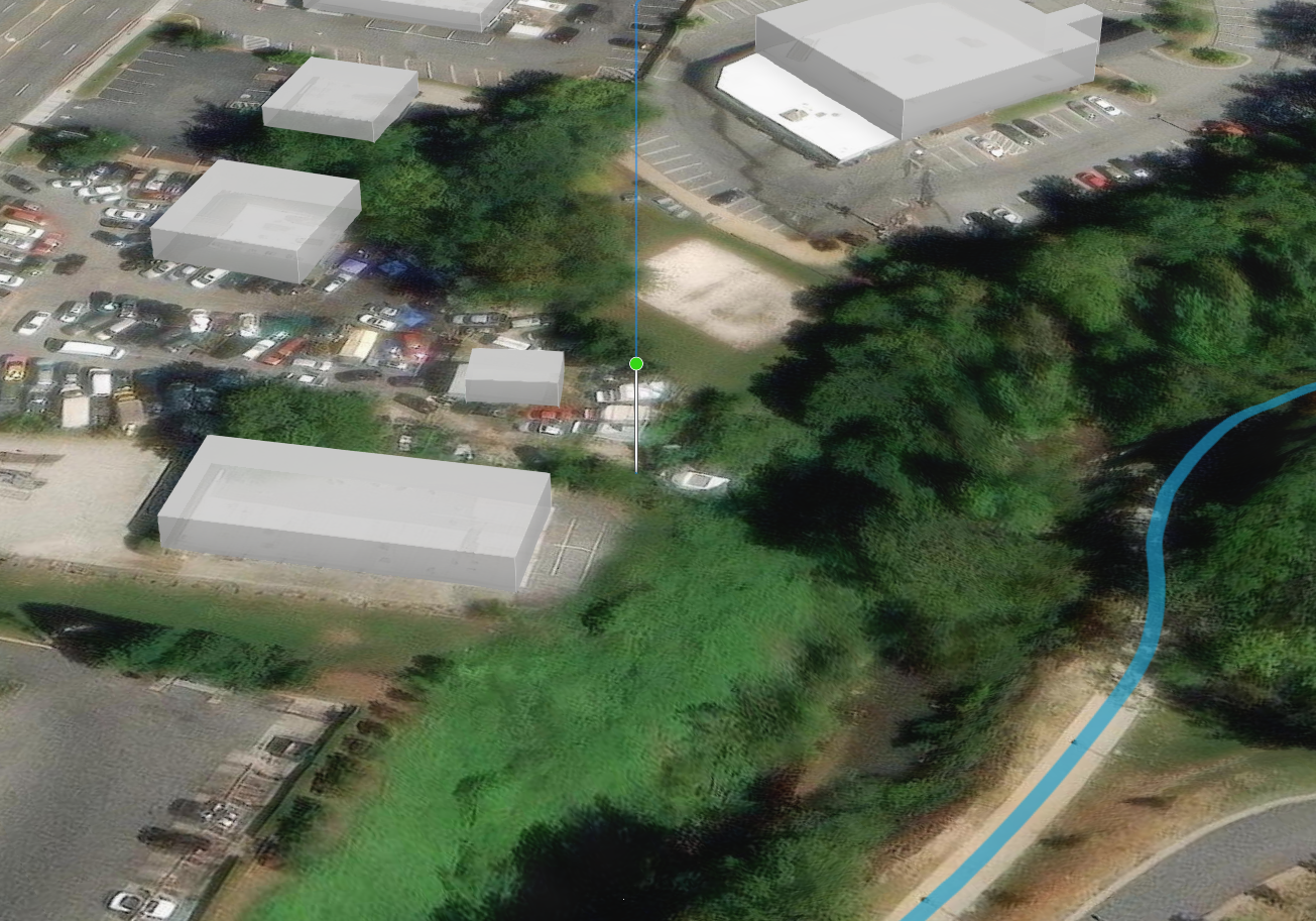

The running of an Experience Builder 3D scene with a Fly Controller performs problematically different in Edge and Chrome.   I'm using "Plan Routes"  The initial view using Edge is what would be expected as shown below with the start pin.  But Chrome behaves badly.

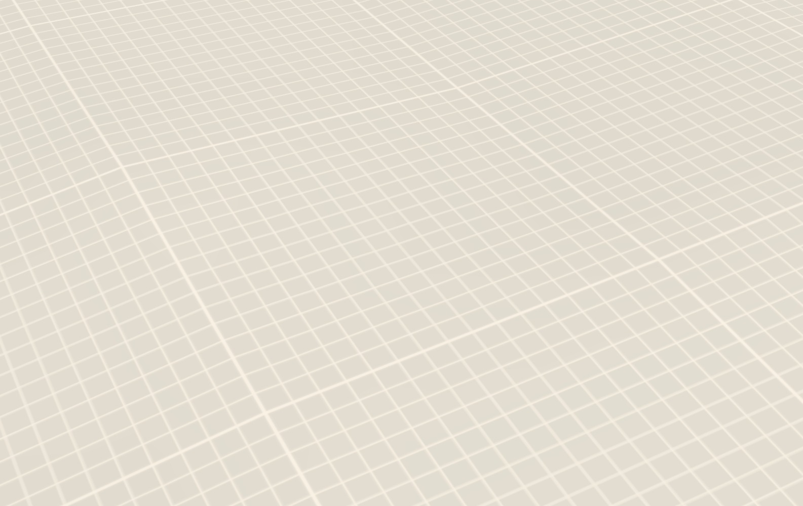

When I run it in Chrome, the start point is not the start point of the path but zoomed into ground level.

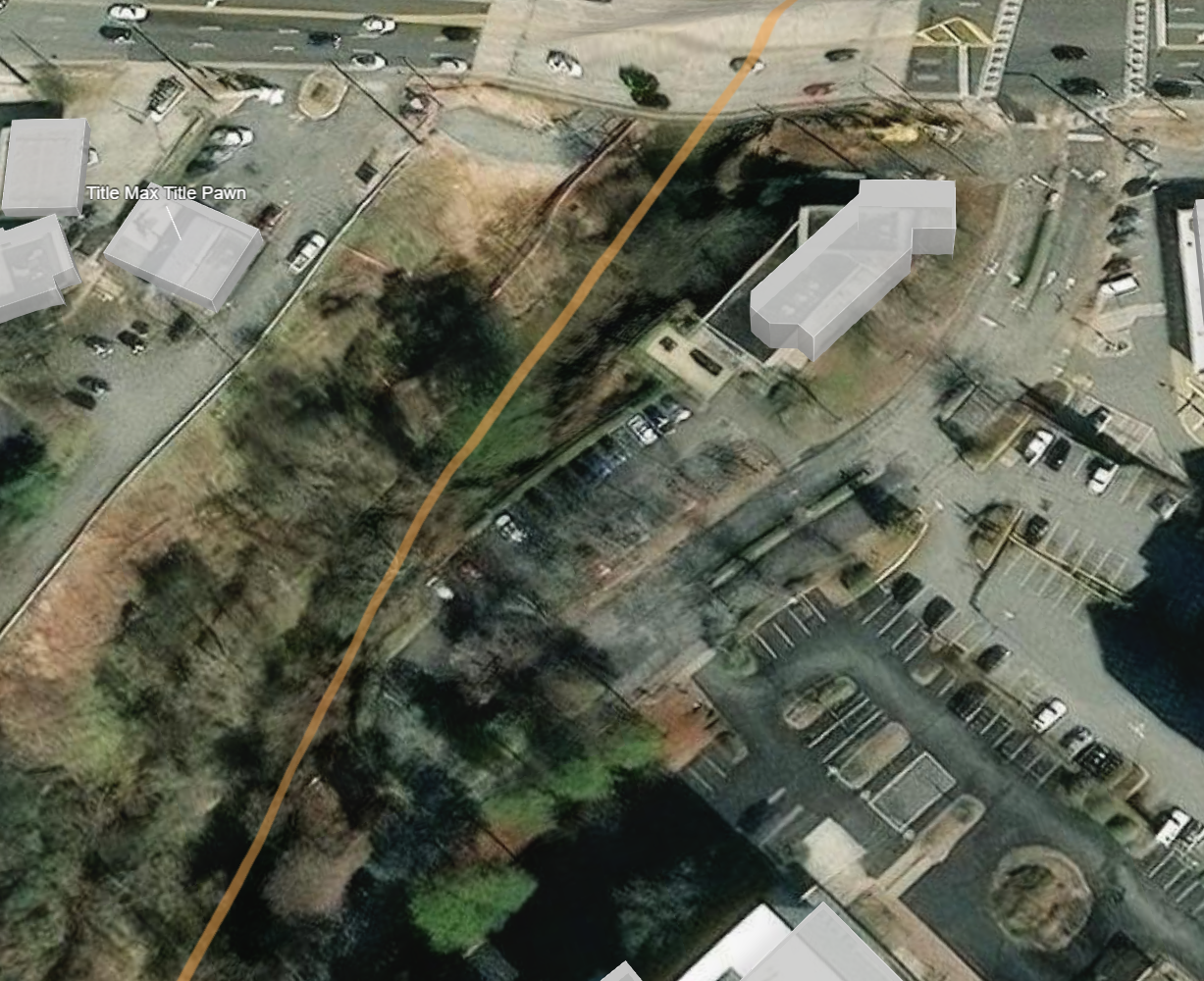

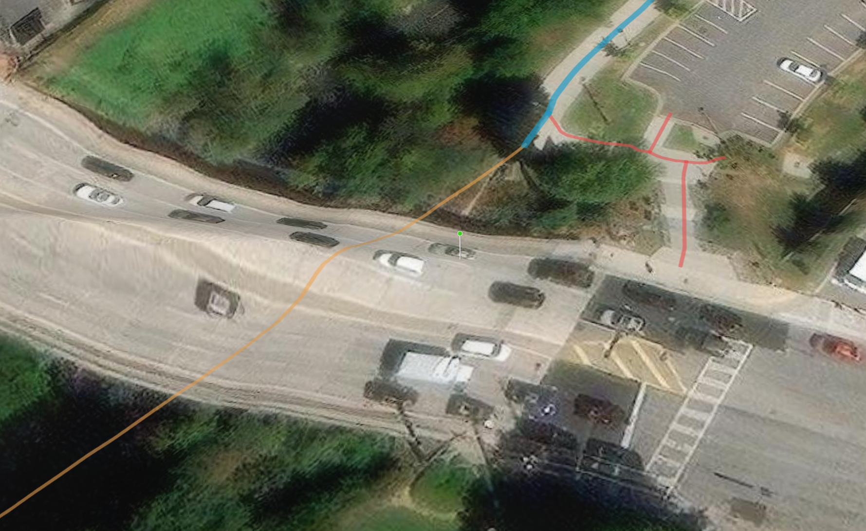

I tried working around this issue in Chrome by adding a point to the route and set it for 0 seconds and 0 degrees rotation.  But it zooms to an off center location shown here in Chrome.  The last screen shot is in Edge

Thank you for all the feedback. I couldn't reproduce your issue regarding Chrome though. Would it be possible for you to provide me with a sample app or a recording showing the bug?
