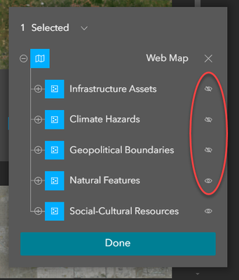

LindaStewart
Technically, it is the same web map, but you will need to add it 4 times to ExB. Each time you click on the "add new data", you can turn off the layers you dont want and it will be added to your data list as a new map. Then in your data, you can rename the map to denote what it's used for
LindaStewart
