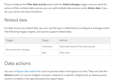

Hi @StickyNoteEnthusiast , I am afraid that many-to-many relationship can be achieved in ExB only through the related data. Here are some references.
Related data configuration in Pro: https://pro.arcgis.com/en/pro-app/3.3/help/data/tables/joins-and-relates.htm#ESRI_SECTION1_2538FFE72...
Related data relationship in ExB message action: https://doc.arcgis.com/en/experience-builder/latest/configure-widgets/action-triggers.htm#ESRI_SECTI...
