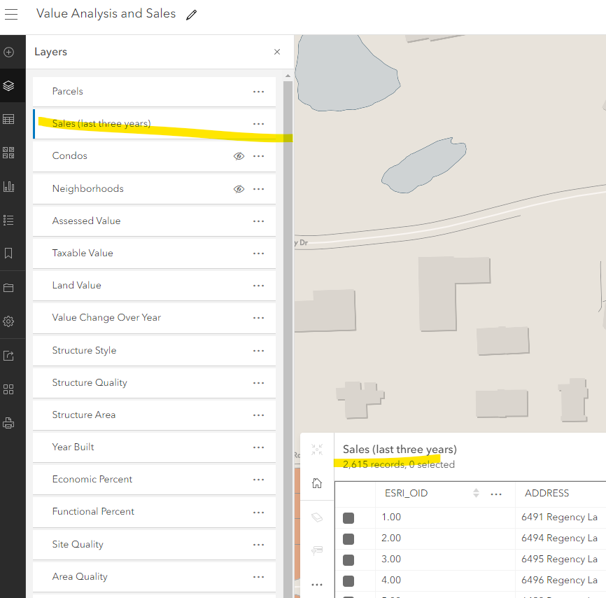

Okay so now the weird part: I've added the layers from the hosted service to my web map and I can see that the number of sales is equal to the number that are in the SQL view.

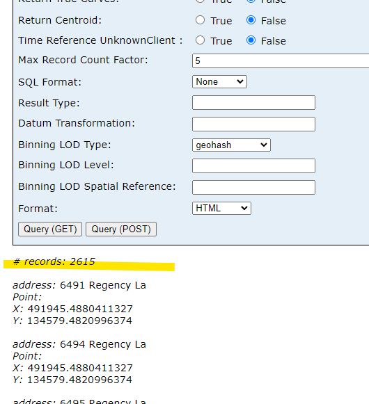

I can also see that correct number querying the REST endpoint:

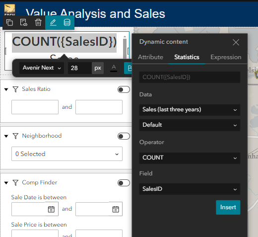

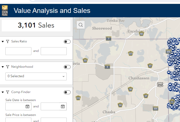

However, my Experience Builder widgets seem not to respond to this update and show the previous number of sales from the initial layer creation:
To test this out, I added the data directly from the URL:
When I use this layer in the widget, it shows the correct number as shown in the web map table/SQL Query/REST Query.
