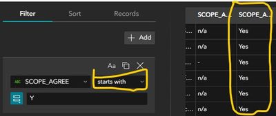

@TonghuiMing I have now found another problem with ExB data filtering that seems to be too much of a coincidence not to be connected with this acknowledged issue.

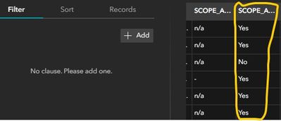

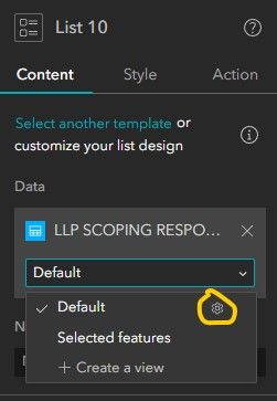

A List widget has a data source. That data source can be filtered via the settings for the data source in the Content tab (Filter/Sort/Records)
No filter applied, Yes/No values in a field

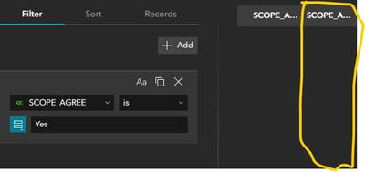

With a 'Field IS Yes' filter applied (i.e. Unique values), no values are returned where there should be many
With a STARTS WITH filter applied the results are as expected
This suggest to me that the same 'Unique Values' issue that affected the Filter widget is also manifesting in other applications of data filtering within ExB framework.
