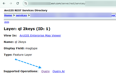

Can you go to your referenced service URL, find the actual layer you're using, and go into the "Query" function:
After that, don't change anything, just put 1=1, and click enter
All the problematic referenced layers that I could find, they share some sort of database error:
The ones that work fine, the filter unique work fine.
These are just my preliminary findings before the sample is provided. I am wondering if you share the same issue.
