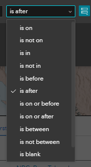

Hello
When creating a filtered data view on a date field, the options to set under the 'is before' or 'is after' options are Yesterday, Today, Tomorrow, Custom, In looking at some other posts, it appears that one can not override these options. For more time-sensitive data, It would be nice to have an option of 'Now'. One can do this currently in the dashboard app, however, it would be nice to import this functionality to Experience Builder

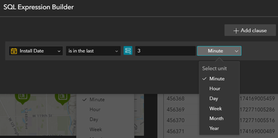

@BrianMorrison - In ExB SQL expressions, the operators "is in the last" & "is not in the last" are ones anchored to Now:
If it does not cover your case, is it possible to elaborate a little more on the details?

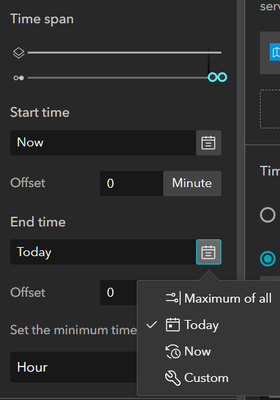

Note that in the new Timeline widget, you can use "Now" or "Today" as a date/time anchor, but only if you convert the data as temporal data:

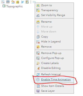

Thanks.  That is helpful.  However, I'm using a reference registered enterprise database that I have published to Enterprise and I'm using the Enterprise REST endpoint in ArcGIS Online.   When I published the registered database with time enabled on the layer, the published Enterprise layer when opened in a web app, has the option also has Enable Time Animation option available as shown below.  Since our Enterprise is at 10.8.1, I'm not able to test out the timeslider widget in ExB.  When I take the REST endpoint of these data and  add it to ArcGIS Online as content, the process completes but when I try to view the data in the new map viewer, the basemap loads but the data doesn’t.  If I try to view the data in the classic map viewer, the data partial loads and then freezes.
