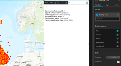

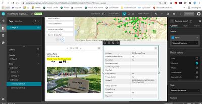

When I change a Feature Info widget from a data layer to "Selected Features", the widget loses the pop-up styling.  In the screen shot below, the left Feature Info widget is pointing to a data layer in the map and shows a nice format as defined in the map layer's pop-up, while the right Feature Info widget is pointing to Selected Features and has lost the pop-up formatting.
Is this intentional?
What I'm trying to do is show ONLY the Feature Info for the selected feature on the map.

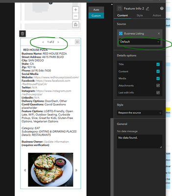

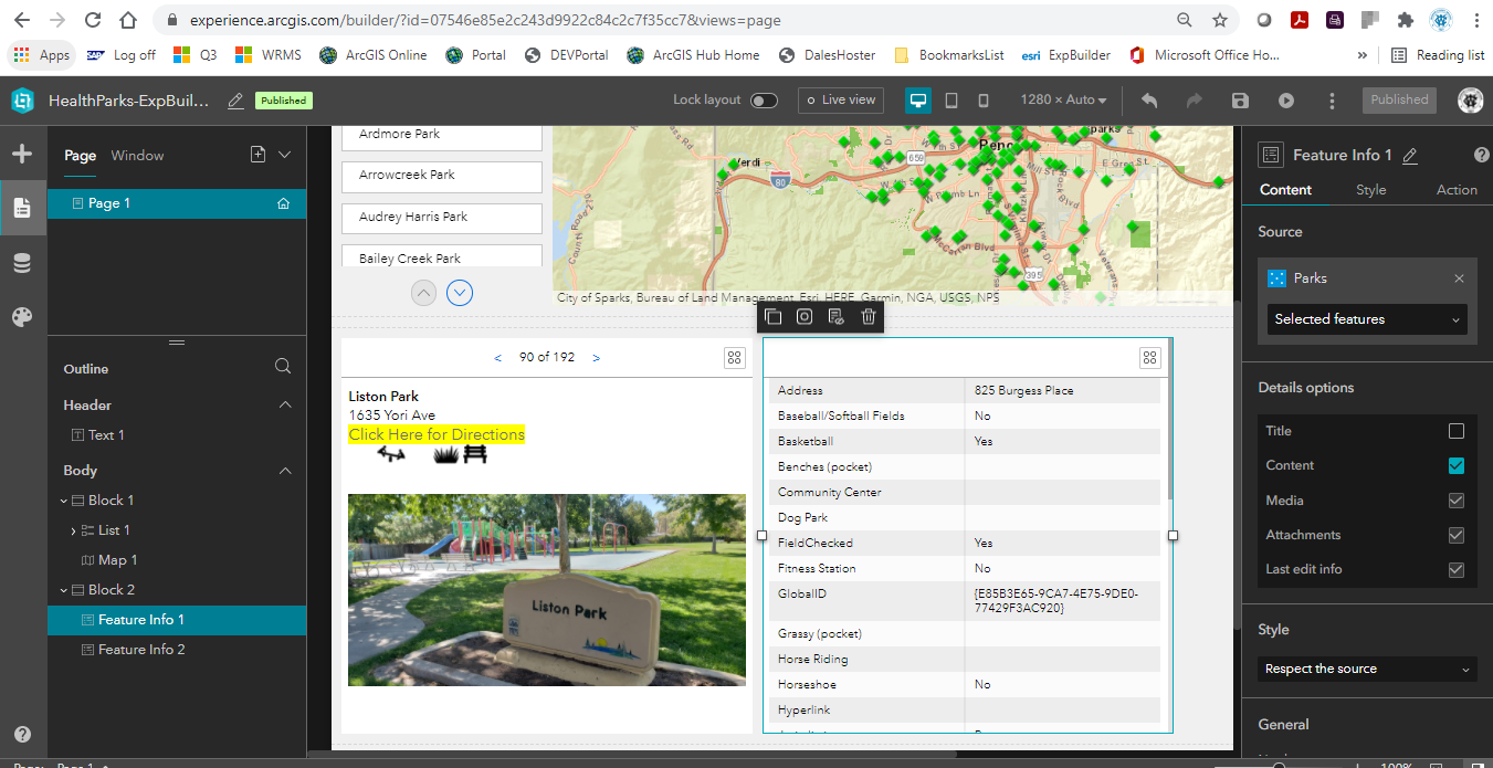

I am having the same issue.  I am trying to configure the "Feature Info" widget for mobile screens.  If I leave the Source as Default the pop-up looks great.  If I change it to "Selected features" it seems to ignore the "Respect the source"
Since it is on mobile I want the user to be easily able to see the feature they selected, not having to arrow through all the pop-ups (there could be thousands).
Screen shots attached to help with debugging.
