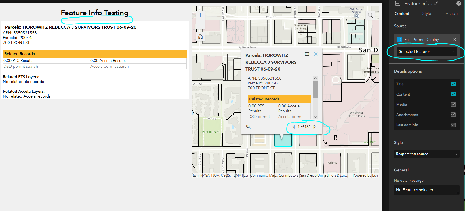

I am having trouble with the Feature Info Widget with stacked features on a map.  I would like to be able to disable the map pop-ups and only use the Feature Info Widget.  The map is using a parcel polygons which are stacked in many places.  For the example map the pop-ups show all 168 features you can easily arrow through when you click on the map.
When I set the Source for the Feature Info Widget to Selected Features only the "top" feature shows in the Feature Info Widget the reset of the stacked parcels are missing.  I would like to be able to scroll through all 168 in the Feature Widget.

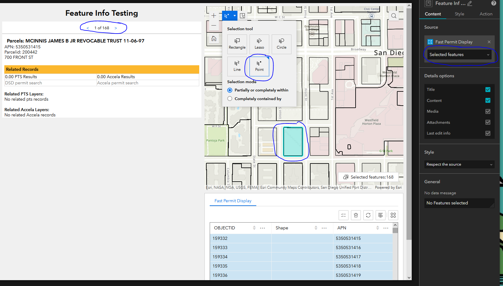

The only work around I have found is to add Select features to the map, change the Selection tool to Point and then click on the point.   While this does work.  It is highly likely a user/public will skip this step and just click on the map, which will result in missing results.  And there will be no indicators to the user they are missing many results.
Is it possible to configure the default action of clicking on the map to give the same results as the above process and mimic the results users are used to in WAB?  The map pop-up behaves by showing all pop-ups in a give location.

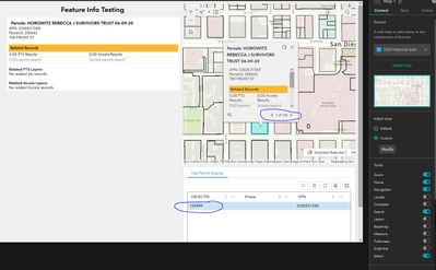

Further testing it seems just clicking on the map has same effect on a table.  Only selecting the "top" feature, when there are 168 features stacked at that location.

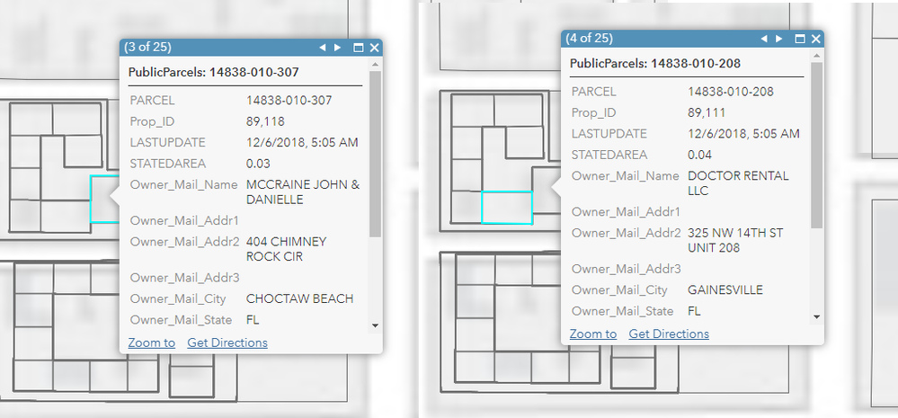

When you see the map popup which includes 168 features, it does not mean all these features are selected. It represents that clicking on a point gives you the adjacent potential results by a certain range, while only one of them - the highlighted one is currently in the selection queue. Notice that if you click the left/right arrow keys, the selection changes one at a time:
This means it only highlights one selected feature. In ExB, we follow this rule and keep all widgets consistent, since clicking on the map only gives you one result (even though pop-up methods display multiple).
In a sense, clicking on the pop-up resembles the behavior of using map select tools (since they both have buffer distance). Thus, the workaround you mentioned above is the solution here.

@DavidColey Yeah, I would say it could provide a better experience for users. Here is another case similar to what you mentioned:
In Map Viewer, if you only click on the map, the behavior follows what I described above; however, if you open the Attribute Table, then click on the map, the selection becomes multi-selection with all 25 results highlighted. It means that the AT here overwrites the popup behavior and then did something extra to handle this case. This could be something we can think about for ENH in the near future.

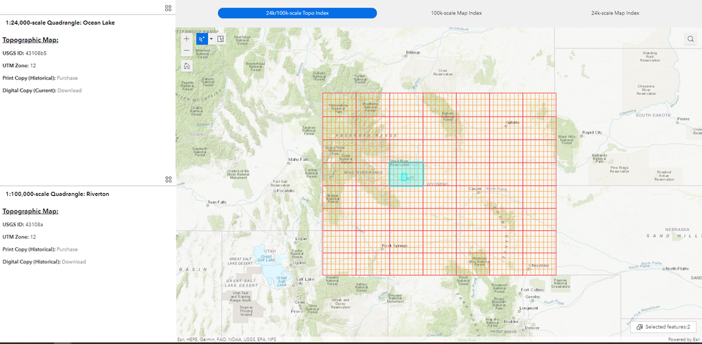

Having a similar issue with creating a 24k and 100k topo index app. The map has 2 layers (24k and 100k). Rather then using a pop up, I thought having 2x Feature Info widgets would be a great idea.. so when a user selects a quadrangle, both the 24k and 100k topo info appears for each scale/layer.
As of now, I can only get the top layer (100k) to appear when clicking on a quadrangle. I also discovered the work around that Ryan mentioned by enabling the Select features option and using the Point tool, but I also agree that the end user will skip this step and not figure out how to access the bottom 24k layer.
Trying to avoid the Developers edition, but it sounds like that's the only workaround for now. Would be great to get this fixed. Cheers
