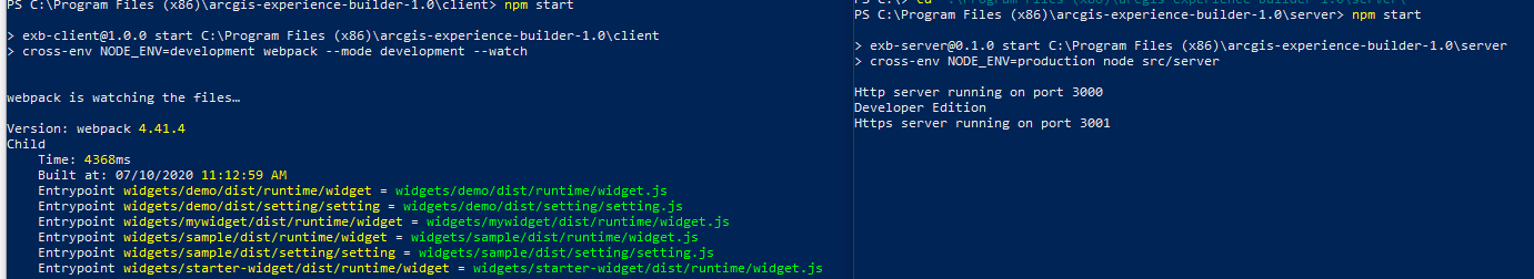

The screenshot below shows how both servers are running -

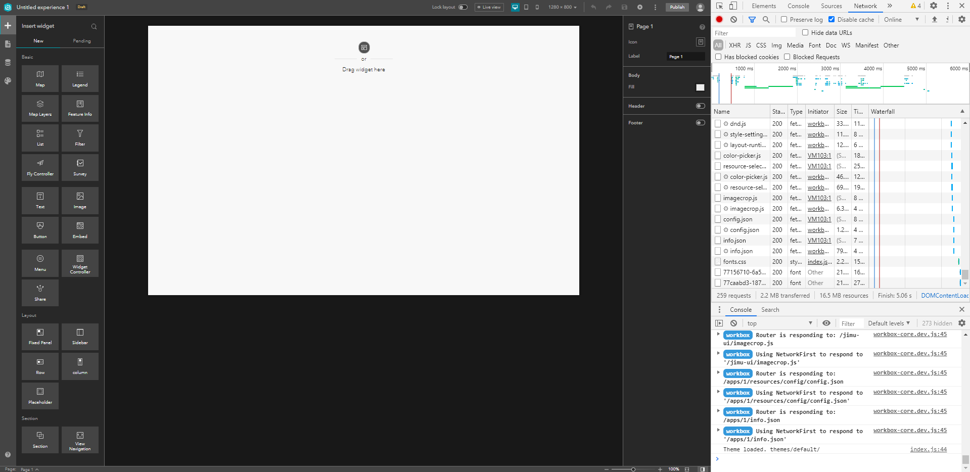

The screenshot below shows my ExB widgets list and no errors in the console view -

I just launched it again and checked with the new Edge & Firefox - still just the 22 OOB widgets. Both NPM instances seem to be fine -

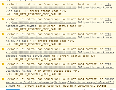

The SSL certificate is working fine, so no SSL errors in the console. There's a long list of workbox instances for the widgets, but none of my widgets are inside that list... I was hoping to dive into the libraries but its all minified.

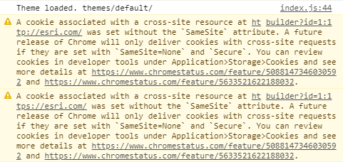

The only suspects in the console are a few warnings about cross-site cookies and 404 on a few workbox components -
