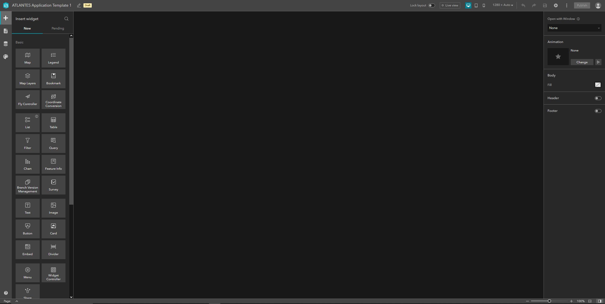

For a while I have been working on a project in the ArcGIS Online version of Experience Builder, but lately I have been exploring the developer edition of the Experience Builder. I am trying to import my Experience project to the developer edition.
The solution I tried, is to convert the original project to a template, and then start a new project in developers edition using that template. However, the new project won't load the template and get stuck showing a black field, like the picture down.
Is there another way to import to developer edition?

I asked about this during the User Conference.  From Gavin Rehkemper: "That workflow (using templates) should work, but I think there may be an issue with the process right now. We are investigating, but it’s possible that it’s due to the ArcGIS Online version of Experience Builder is currently newer than the latest version of Developer edition. I’ve brought up this issue with the core team, but as a short-term workaround, when version 1.5 of Experience Builder Developer Edition is released (should be within next few weeks), it may start working again."

You can use ArcGIS Online Assistant to copy the JSON file of your Experience (made in AGOL), then inject it inside a blank project within your Experience Builder developer edition.   It's a bit of a hack, but it works as long as you use the latest version of ExB Dev Edition 1.11 (note: 1.12 coming mid-July2023).
