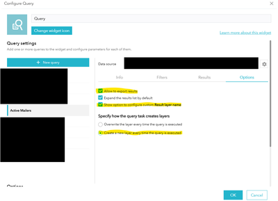

I was testing this out in AGOL, but it looks like you can only output 1 query result at a time in the Map Widget. Every time a new query is made, it overwrites the query result layer in the map. This is different than how it currently works in Web App Builder - it allows you to create a new layer for every query, which is what we need. In WAB, you can check a box that says "Create a new layer every time the query is executed".
Is this slated for development? This is the one thing we need in order to migrate away from WAB.
