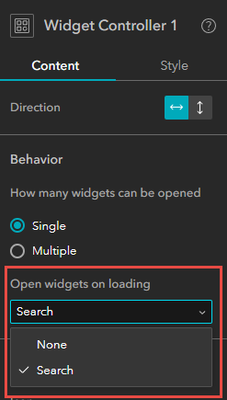

There are two workarounds:
One is to put the Search widget on the homepage and show search results on the Page 0, the button can be set back to the home page.
The other one is to put the Search widget in a widget controller and set the Search widget opens on loading.
