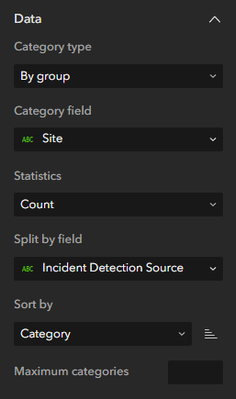

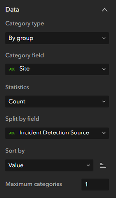

JohnMoore12
I am experiencing a similar issue in Experience builder right now.  I believe there is an issue with the maximum category option when users sort by values.  when I attempt to sort by the count of my category field, then only show the top 15 I receive an error.  The image below is the configuration that works as expected, but when I switch the parameters to image two, the chart breaks.
something to look into.
