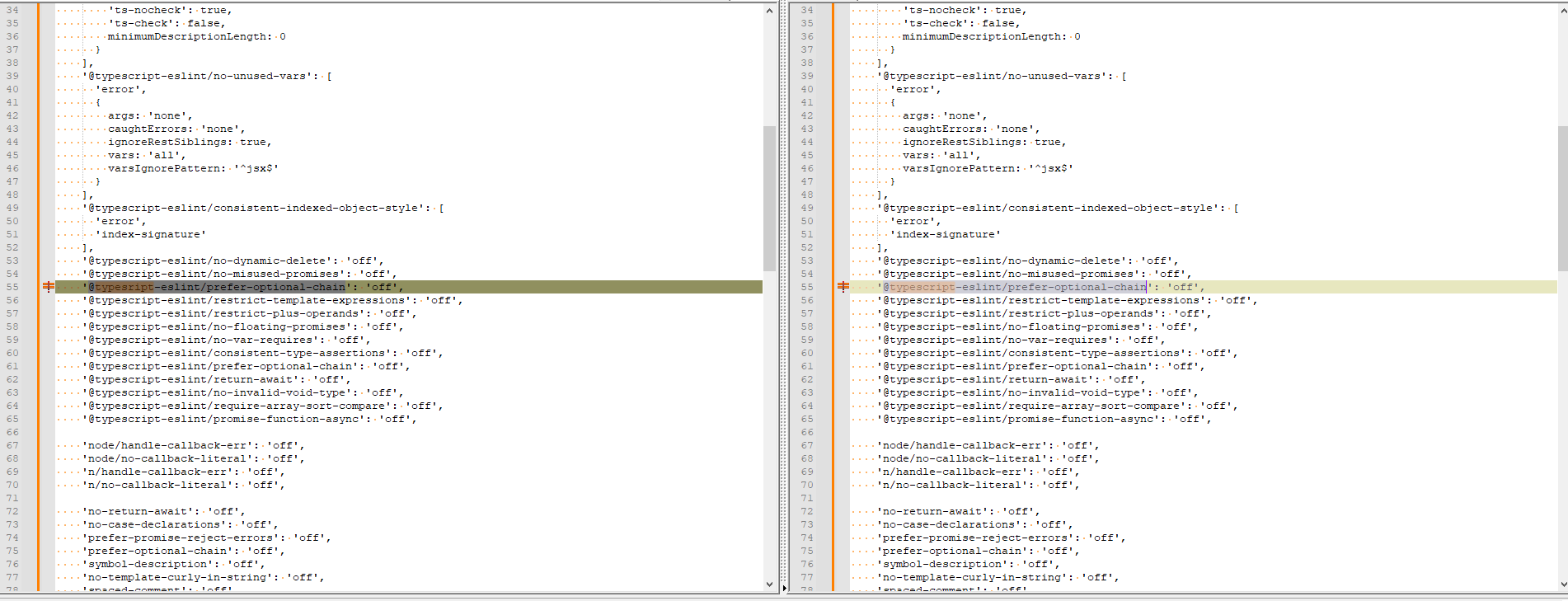

This morning I was trying to resolve an issue with 'imports' not resolving in WebStorm, while doing so, I noticed that on line 55 of .eslintrc.js in the client that the rule for prefer-optional-chain appears to be misspelled
The rule name is currently: @typesript-eslint/prefer-optional-chain
it should be
@typescript-eslint/prefer-optional-chain
Also note that it appears this rule may be in the config file twice, once with the right name once without.  I don't think this is related to the issue I was looking into, but it might be important to fix in next release.
Here's a screen cap from a comparison tool to show the difference:
Suggest it be updated when practical, and other users can make the update themselves in ArcGISExperienceBuilder/Client/.eslintrc.js

Hi @TimWestern Thanks for your feedback! We'll fix it in the next release.
