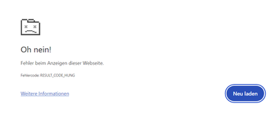

All the code is working good and the widget makes what it supposes to do. But suddenly everything stops working and I received a message from Chrome (Image 2) and it says that the browser is out of memory. I already did what Crhome suggests like: cleaning cookies, uninstall chrome extensions, reinstalling Chrome, etc. But I don't find the solution. I have other Experiences with other custom widgets and they work good, the problem is just with this widget. I am working with Experience Builder V 1.14 release date 20.03.2024.
Image 2. Chrome message

DiegoSatian
Hi Jeffrey,
Thank you very much for your answer and advices. I already fixed the problem, it was something in my code. But I will read more about the client-side quesry topic. Besides that, I am also trying to make my widget more simple and not so memory consuming. In terms of limiting the area, I thought about that and the analysis just run for the features contained into the map extent.
