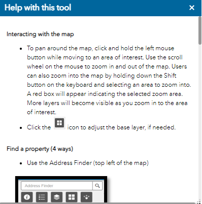

I'm creating an ExB application and within it I have an About window that has some instructional text. I'd like to add images and icons to the text box similar to the About window in WAB. I can't seem to figure out how to do this within ExB. Is it possible to add images to text boxes?
Image of a WAB About window for reference:

It looks like you want to be able to add some free form HTML in the display, like those widgets that have a rich text format view and and a code view.  The text widget doesn't appear to do that.  You could use the Simple custom widget that ESRI provides with the Developer's Edition and make your own using React etc.  Another option is to make an external HTML page, and then use the Embed widget to display it.
JeffreyThompson2
MVP Frequent Contributor
You could use the layout widgets to arrange Image widgets between Text widgets. You'll get the best results avoiding in-line images and using the Fixed Panel/Row/Column widgets, but if you really want to do in-line images you could try the Grid widget.

Unfortunately, it is not possible at this time.  Please consider adding a kudo to this idea.  Combine Text with Images - Esri Community

Hi everyone, my workaround for this was to pull in a list widget into my Widget Controller, change the name to "Map Tools" and the icon to something other than the list icon. I then created a spreadsheet that had a map tool title field, image url field, and the text field. I filled these out and then used dynamic text within the list to create the Map Tools panel for my map application. I think it worked pretty slick and looks nice.
