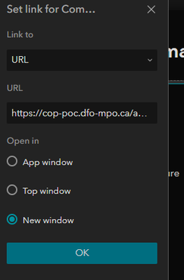

Yuriko
Hi Henry, this is a very late response and you've likely solved your issue if not when you posted a couple years ago, then with subsequent versions of EB. But with the 10.9.1 version you can create a hyperlink 'Add link' via the 'Page' view, then 'Set link' while selecting the 'New window' radio button option.
