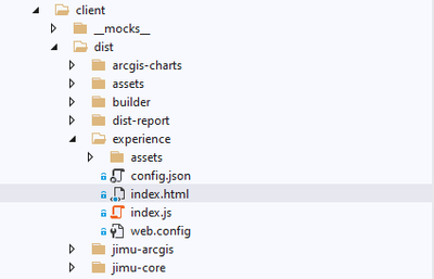

Find the index page here.

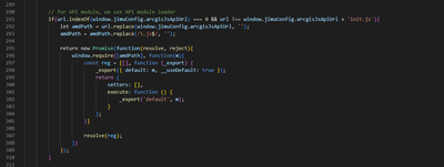

Then locate this code
This is the code that causes the issue, as its trying to access window.require before its available. You can replace that with this.

What this code does is check if window.require exists,if it does then continue. If not, wait one second, then try again. You could maybe change this to a while loop, but I've found one second was enough.
I realise this is a bit of a hack, but if you are stuck and need a last resort then hopefully this helps. You would need to remember to add this in anytime you upgrade. But as its in the dist folder it gets copied out anytime you download the experience to be deployed.
