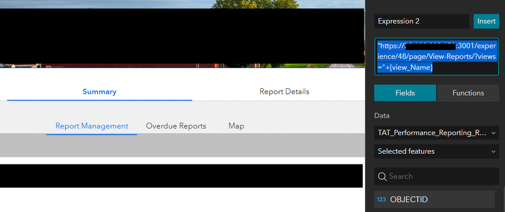

To call the view in the List Button, I use this URL expression:tempsnip.png
Following the documentation here: https://doc.arcgis.com/en/experience-builder/latest/build-apps/url-parameters.htm
How would we best expand the URL expression ,
"https://35.188.xxx.xxx:3001/experience/48/page/View-Reports/?views="+{view_Name}
to include the filters between the list selection record using field: ReportID in the List, and record included in the called view, which also would use the field ReportID value in the filter)
