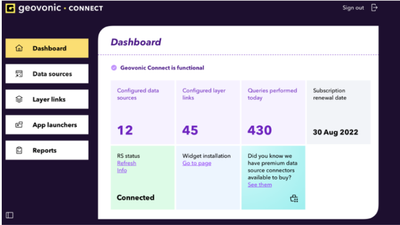

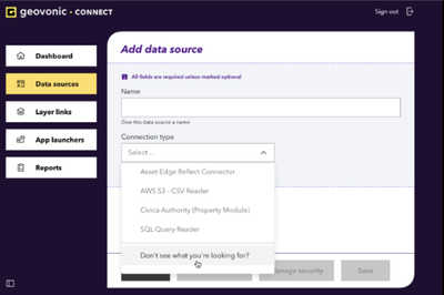

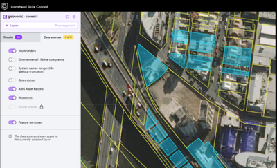

Geovonic Connect [link] (ArcGIS MarkePlace) enables you to bring information from your 3rd party software inside your ArcGIS. This simple but clever Experience Builder widget is designed not only to bridge workflow gaps but to drive efficiencies.
We use it with many clients (utilities/city councils, etc).
Enable users to select features on a map and view associated third-party information, retrieved in real-time via the Geovonic Connect widget.
A range of retriever and connector plug-ins are available for purchase and custom plug-ins can be developed on request. Existing plugins provide real-time integration with Salesforce, Sharepoint, Civica, TechnologyOne, relational databases, AWS, weather services, Google and file-based data sources.
Installing "Geovonic Relay Service" on your internal network allows for easy and safe connection to the Geovonic Servers,  holding the "link matching query" between one system and the other.

JoClarkeBega
Fred - we are implementing Geovonic connect here, and while the Civica Authority connectors are certainly easy to configure,  I am finding the range of Authority Altitude data connections very limited. Owners but no contact details for them, nothing for Water Meters/Accounts, Charges or Property attributes or Registers. Are these likely in future or do we need to make use of APIs for these? Thanks Jo
