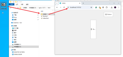

If the app is just a plain site without ArcGIS data, you can unzip it and send it to your web server directory.
But it's another question if your app involves non-public data or other privileges.
