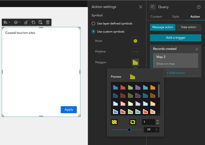

The function has been provided in the latest AGOL 10.2 release - now you can customize symbols for the Show on map message or data actions for available widgets.
AmyHut
Could you direct me toward where I can access this setting? I'm trying to mimic in experience builder the appearance of a widget used in web app builder, and the yellow default will throw off users. Thanks in advance!
TonghuiMing
Show on map message action

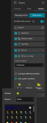

Data action

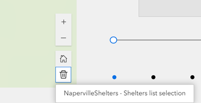

For results added from data actions, you can remove them directly from the map
