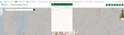

MelanieNeedle
Thanks for looking into this. @ShengdiZhang Were you not able to access the print service widget?  Screenshot provided to show the error received.
ShengdiZhang
Hi @MelanieNeedle ,
I can access your print service now and reproduce your bug.
However, as I said earlier, the print success if using the default AGOL print service https://utility.arcgisonline.com/arcgis/rest/services/Utilities/PrintingTools/GPServer/
I think this bug is probably due to something related to your print service.
Thanks,
Shengdi
