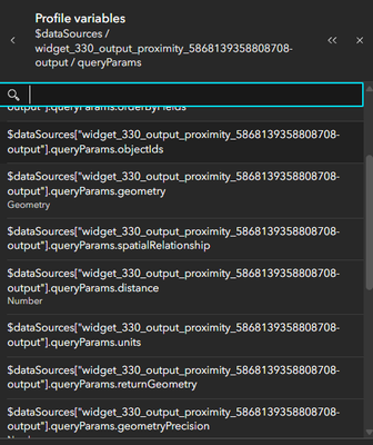

I would like to access input distance of Near me Widget, needs to display same in another widget using arcade.I tried this and nothing is showing
Text($dataSources["widget_330_output_proximity_5868139358808708-output"].queryParams["distance"])/*

In the Arcade suggestions box, I can see all available functions and properties. However, the issue is that I’m not able to retrieve the data from queryParams.
The previous snippet only displays the distance of the first feature, not the input search distance
