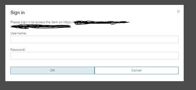

It appears Experience builder is not supporting SAML IDP Authentication with ArcGIS Enterprise Portal layers.
When accessing an Enterprise Portal Layer in EB, it prompts for a named user login instead:

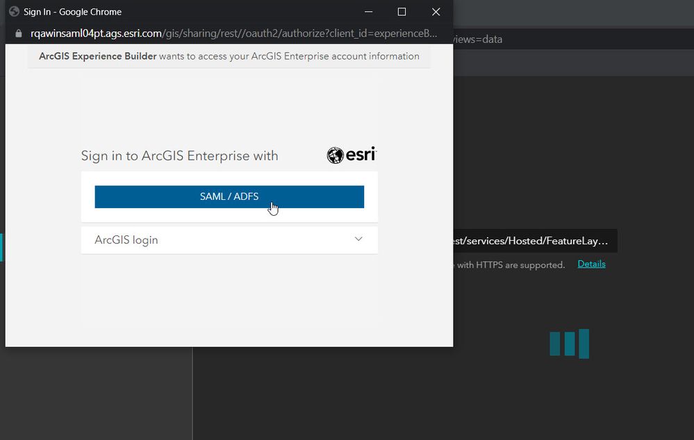

I am seeing it in both Chrome & Firefox, cleared cache for both. This data is shared from our QA Portal as a collab to ArcGIS Online. It does prompt me as expected when I go to the item details page:
To rule out the collaboration part as well as an issue with QA Portal, I added a Production Portal rest service which requires the same SAML authentication into a blank map, and into a blank Experience Builder -- same result:
I will email you a test service URL to try. Thank you for your time!

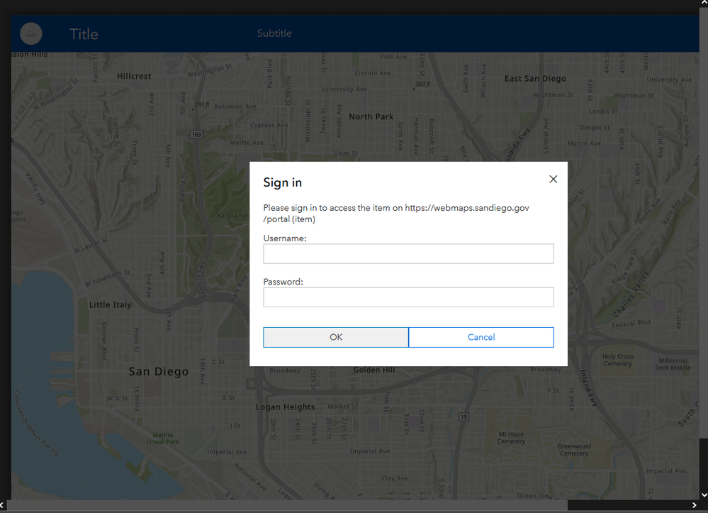

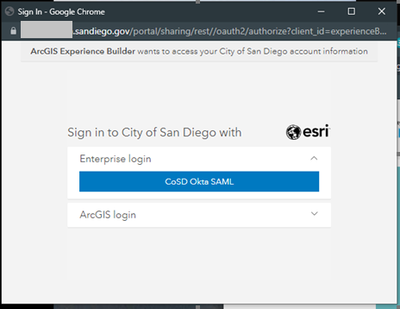

Can this patch be downloaded?  Does it get applied to the portal?  I'm encountering this same issue in the current AGOL environment.  If I load the webmap it does the normal OAuth2.0 authentication correctly but in the ExB app the web map is in it will request a built-in login which we have disabled in favor of SSO.  Even if I create a fresh ExB and only try to drop in a web map I get this login prompt.  I'd try the registering workaround given elsewhere in this thread but it sounds like that doesn't apply to a AGOL ExB, just a custom one you can edit that config.json.  Maybe I can do it in AGOL using AGO Assistant?

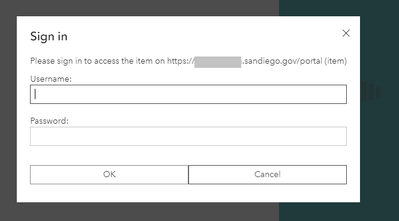

I have a similar situation, our customer has ArcGIS Enterprise 10.9.1 with SAML authentication. We have built ExB web apps using Experience Builder 1.8 Dev. Ed. and deployed them to a IIS web server. The webmap is shared with the organization. When we open the app we get presented with the following login screen to authenticate for the web map item.
Whilst we can log in with portal user accounts we can't log in with SAML. Is there something we need to do to configure the standalone web app to authenticate via OAuth2?
Jianxia
This can be achieved by registering the app in portal. See the step 3-6 in the topic below to evoke Oath sign in dialog.
https://developers.arcgis.com/experience-builder/guide/deployment-topics/
