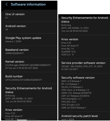

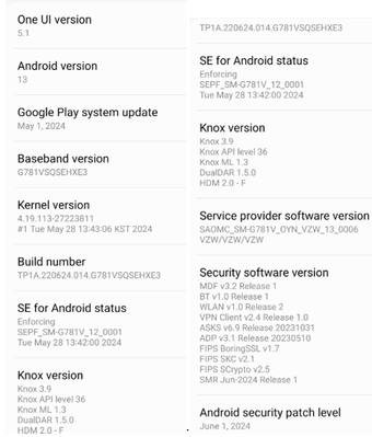

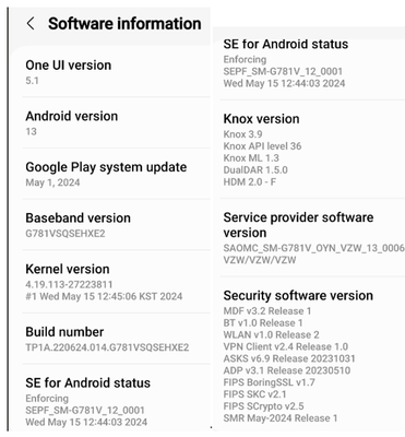

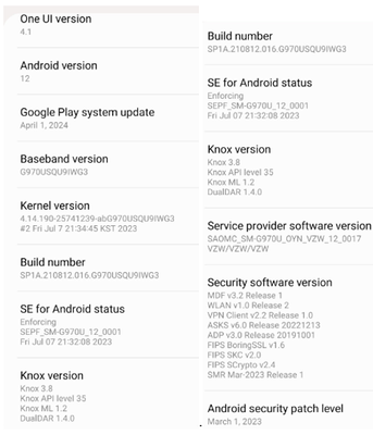

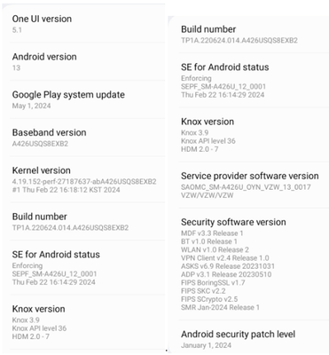

Screenshots of just a few of the Androids that succumb to the bug. If any theme emerges, hopefully this will give Esri engineers a clue how to resolve.
AlexErnst_IDPR_0-1720327138348.pngAlexErnst_IDPR_0-1720327138348.pngAlexErnst_IDPR_1-1720327173632.pngAlexErnst_IDPR_1-1720327173632.pngAlexErnst_IDPR_2-1720327208369.pngAlexErnst_IDPR_2-1720327208369.png
Samsung S10e AlexErnst_IDPR_3-1720328615699.pngAlexErnst_IDPR_3-1720328615699.png
Sam A42 (A32 work fine though!)
