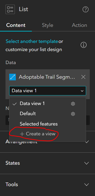

GTueller
I have done this before by using the same data layer for the list but creating a new view for it. It will prompt you to create a filter for the view, but you can just leave it blank and then the list will show all your data, and when you search the list, it won't filter the map.
