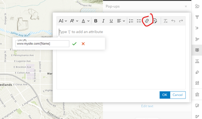

If you can make your pages predictably named based on some aspect in the feature layer, you can configure your webmap with a link something like this.

If I do {Name} like above in a webmap url, it will grab the value from the {Name} column in my feature layer, so if you have a column called SpeciesName in your table and you make pages that match your species names, you can build links like www.mysite.com?page={SpeciesName} and get a working link for each species.
