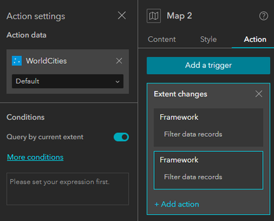

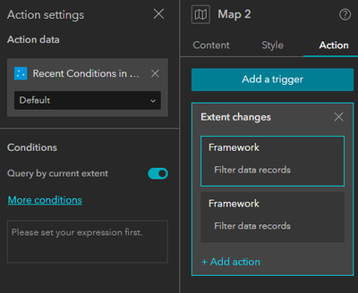

Map extents can be used to filter multiple data layers, but you need to add actions for each layer within one trigger.
Add action for data layer used in chart 1:
Add action for data layer used in chart 2:

When I add the first "Extent" trigger, it removes the option to create a second extent trigger.
ShengdiZhang
Hi, you can click the Add action button to create another action for the trigger Extent changes.
KarenHiggins
Whe I go through this process it only allows the "framework" to be filtered. This works for one layer but if you add a second layer to the map (and a chart using it), it is not filtered.
