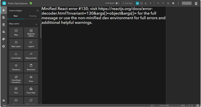

JuanMarvinW
Just noticed this problem today, after upgrading to 11.5. Happened when I entered the experience builder (edit an existing WebExp file, or create a new WebExp), and on Ms Edge. Launching the already-published apps are good though, as long as not entering the Experience Builder page with MS Edge.
Tried using Chrome (Standard version, non-incognito), both before and after clearing cache it worked fine.
This is my screenshot when using Ms Edge.
My current workaround is to work using Chrome.
