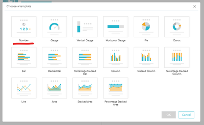

KirstenMason1
Is the number option of a chart also only available in 11.4? I'm using 11.3 and I'm trying to create a dynamic infographic within ExB but I'm struggling to find options.

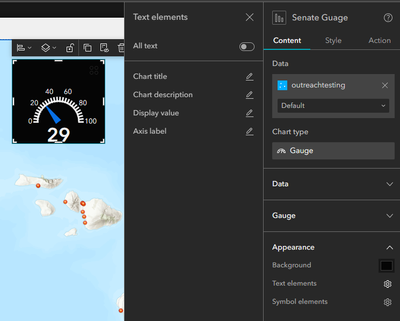

Dan_kmnh
Decent looking gauge, thank you Esri.
BUT, no way to label the gauge?! REALLY?! I see the settings to adjust the Title and Description elements on the Appearance 'tab'. Did I miss where to actually type a title and description?
Wei_Ying
hi @Dan_kmnh ,
It is a known limitation for gauge chart that it does not have title and description option.
Please use text widget to add on top to chart as a workaround. We will fix this issue next release.
Sorry for the inconvenience and Thanks for your understanding.
