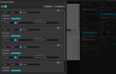

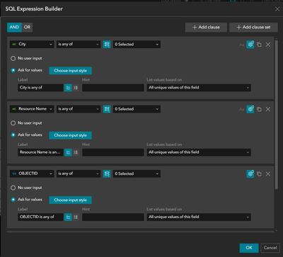

I have an Experience Builder app where the map displays roughly 28,000 points across PA.  I set up filters based on values and set them to values filtered by other expressions within the filter.  It initially worked; however, it repeatedly fails to find any values in the filter and will say "No Data".  Sometimes clicking around the map will make the values reappear, but lately it will not do anything.  During the initial build, it usually works fine.  After a few tests, it cannot find values to filter any more.  All of the values are there, it just will not recognize any.
I also have a table view of the data that filters to the extent of the map - not sure if this could cause an issue.  I tried removing it and the problem reoccurred.
Thank you!

Hi @DamienMscisz, @kmsmikrud
In which version of Portal did this issue occur? Could you please provide a screenshot of the Filter configuration page?

DamienMscisz
We are using the Enterprise Portal.  Screenshot below.  Thanks for looking!  As a quick fix, I switched all of these to value contains and users can input names.  That works perfectly, but I'd rather use a filter.
