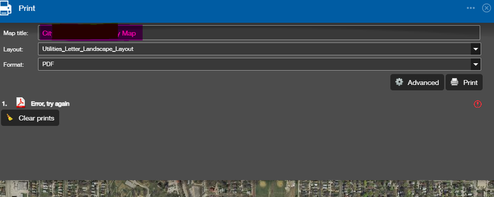

Hi all, our print function seems to be down today with experience builder. I tried clearing my cache, opening the application in a new browser, etc. None of those actions worked. Is there some hidden workaround i could do?
thanks GJ
GeorgeJonesRIGOV
I got it to work. Just add to take off the old layers and re-add them. It worked when i did that. Thanks for the help everyone!

@GeorgeJonesRIGOVIs your experience builder on AGOL or enterprise?
GeorgeJonesRIGOV
Enterprise. We recently got an upgrade and was wondering if that was the case.
