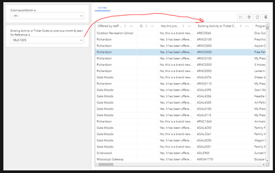

We're looking to use your product for tabular data editing, but we need a way to filter the data. I've prototyped an Experience, but it appears that the Filter widget does not work with the Data Table widget.
Is this something that is intentional, on the road-map, or is there a setting I missed?

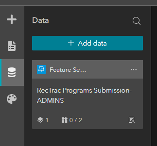

The data source is the same for both the table and the filter widget. When clicking on the filter widget's actions, there are no data options.
See image below- that the data is not being filtered:

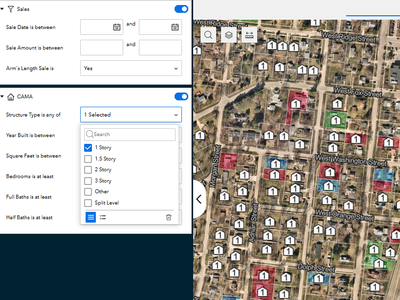

We've successfully implemented a filter/table combo in EB, so it is possible.
https://maps.co.kendall.il.us/betaviewer/?page=page_2, for reference.

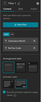

Looking at your screenshot, are those two items in the Filter widget acting on the same data source? And if so, is your widget set to "OR", perhaps?

To answer your question Josh, It's set up just like yours using the AND option:

That would be strange. I should have given my screenshot with the table visible, not the map, but there is one there.

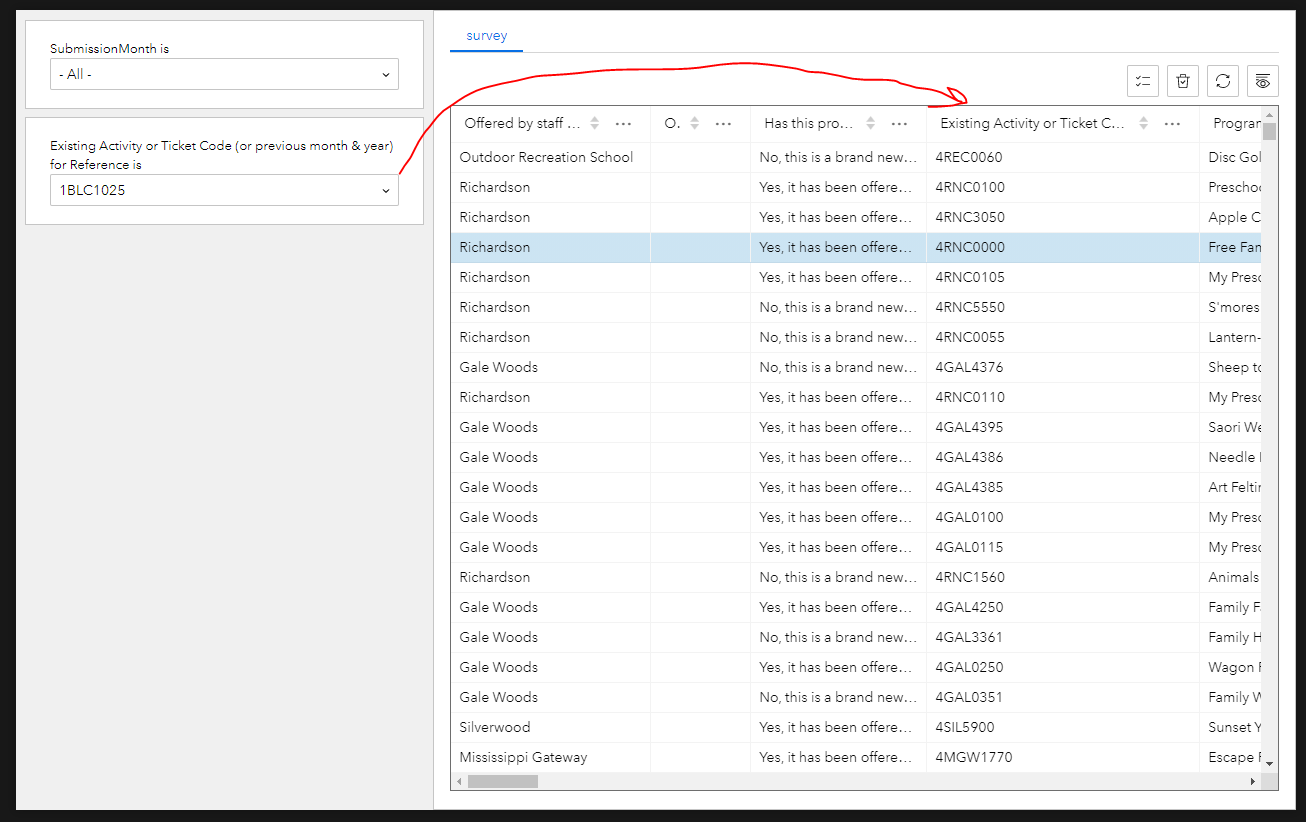

Update- I added a map widget with the data and it miraculously started working- this suggests that there is an issue with filter widgets and data tables as a standalone product.
@TianWen can you reproduce on your end? There are plenty of use cases where users will need to filter visualize tabular data without the need for a map.
