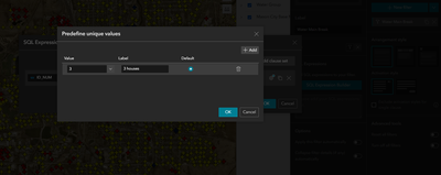

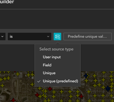

use unique pre defined values in the filter widget. you can set the label to whatever you choose.
