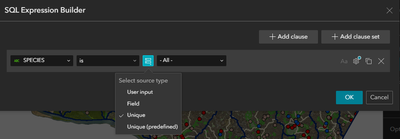

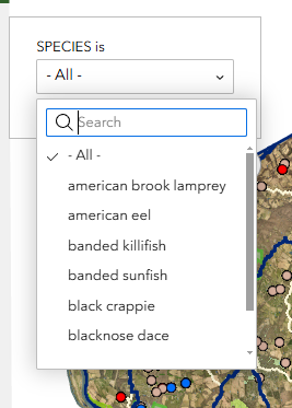

I using Experience Builder with a filter to chose what value (fish species) I would like to display.  Only the first half of the species appear in the dropdown.  If I type in a species I can get to the ones that are not visible.  However, I would like the whole species list to show.
Does anyone have a work around to get the whole list of species on the dropdown?
See images below.

Mine continues the list once you keep scrolling down.
GeoffreyMason
Interesting.  Mine displays 34 values but won't scroll any farther down the list.

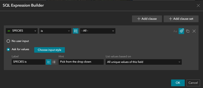

What does your whole exp builder look like?

What I discovered regarding this topic today is interacting with the filter widget via the dropdown list in "Live view" results in a truncated list that doesn't show the full list of options. A workaround is to use the "Pill selector" if the list is not overly long. For me, the "Pill selector" input style displayed the full list of options.
The other thing to check is to check whether the full list of options appear in the "Preview" app or the published app. For me, the full list of options appear in the "Preview" app or the published app, just not in the "Live view" when editing the app.
