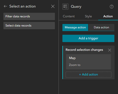

Hello,
I'm creating an ExB application which includes dynamic text in a text box. I can get the dynamic text to update based on a selection in the map, but is it possible to have it update based on a query made in the query widget? I can't seem to get it to work with any of the actions. Any help is appreciated.
Thanks.
JeffreyThompson2
MVP Frequent Contributor
If you've already configured your Dynamic Text to work off of Selected Features, you're almost done already. In the Query Widget, add a Record Selection Changes > Framework > Select Data Records > Your Data Action. Whatever is selected in the Query Widget should then be used to update the text.
