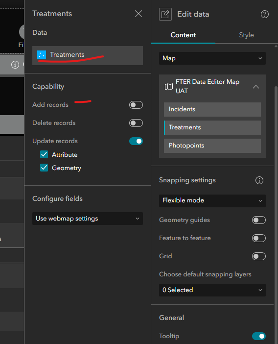

I have multiple layers and I want different editing capabilities for each. The app has been published with an attribute-only edit functionality for the Treatments layer.

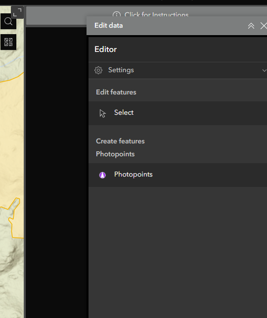

In the Editor, with nothing selected, the option to add a record to the treatment layer is disabled, as desired....You can see below where it's not an option in the Editor.

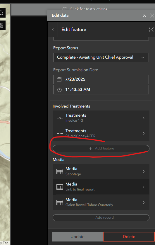

However, when I select the parent record, and I navigate down to the related Treatment records (which I would like to be able to do), you can still see '+ Add Feature' is available, and you can still add features, which is what I explicitly disabled. The ability to edit in this fashion is enabled in the Form in the webmap, but there's no option to specify editing type.

I have confirmed with the team again that related records can be created or updated if the update capability of the parent layer is toggled on. So the child layer's privileges cannot be dissociated from the parent. Experience Builder is dependent on how this was implemented across the platform.

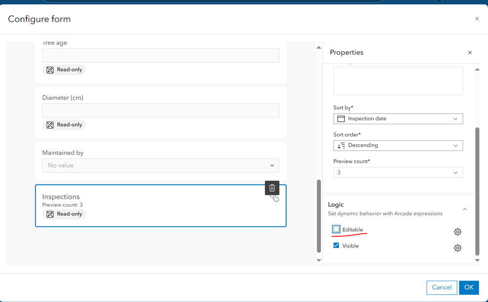

@SFM_TravisBott, I think something else that may be interesting to explore is if you are able to leverage the conditional editability and/or visibility logic for related records when configuring the Form for your parent layer. You can turn off editability for related records there. I think you could also add a condition so related records can only be edited based on if the parent feature is being added or updated, so even write up some attribute lofic to determine editability/visibility.

What you’re seeing is the Editor widget not fully honoring the editing settings defined at the layer level, especially when it comes to related records. Even though you’ve disabled geometry editing or creation for the Treatments layer at the map level, once you access it through a parent feature, the widget still exposes the + Add Feature option — basically ignoring your intended restriction.
From what I’ve seen, the widget relies more on what’s defined in the form configuration of the web map than on what you set in Experience Builder’s widget config. And unfortunately, when editing related tables or layers, it doesn’t give you granular control over what’s allowed — like attribute-only edits vs. feature creation.
