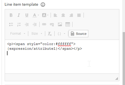

AndresCastillo
MVP Alum
It is also possible to use the embed widget to embed a dashboard url.
In the dashboard, use the list element.
On the Data tab, connect it to a dummy layer.
In the List tab, write this code in the 'Advanced formatting' box:
var time = Now()
return {
   attributes: {
     attribute1: time,
In the line item template box, write this code after clicking the 'source' button:
<p><span style="color:#ffffff">{expression/attribute1}</span></p>
