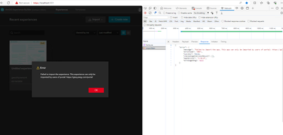

RachappaBellappa1
Same issue for me AGS Enterprise Version - 1.10, Dev Edition 1.10 but when i try to import the app it gives me this error app can only be imported by users of portal. I even tried importing on 1.12 but that didn't work. Any thoughts?

TianWen
@RachappaBellappa1 The application you're trying to import is sourced from a different portal than your current logged-in account. Please note that app imports are limited to those within your organization. Please refer to the doc https://developers.arcgis.com/experience-builder/guide/import-apps-or-templates/ .
