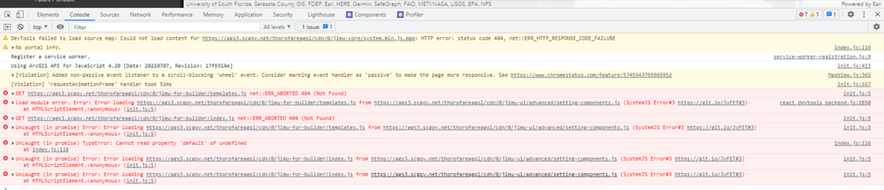

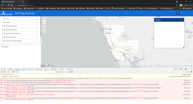

BUT, a Street layer for Query Widget, selected from the map as the data source, is NOT available to the query widget. I get a whole host of jimu errors when I open the query widget:
This could not be a more simple deployment.  I'm just trying to get some simple things resolved before trying to add in custom widgets and code.  It shouldn't even require a client id because everything is public.

@DavidColey The jimu-for-builder package is not included in the download package, this bug will be fixed in next release. To workaround this bug, can you try to copy this package from client/dist folder to your deployment folder to give it a try?

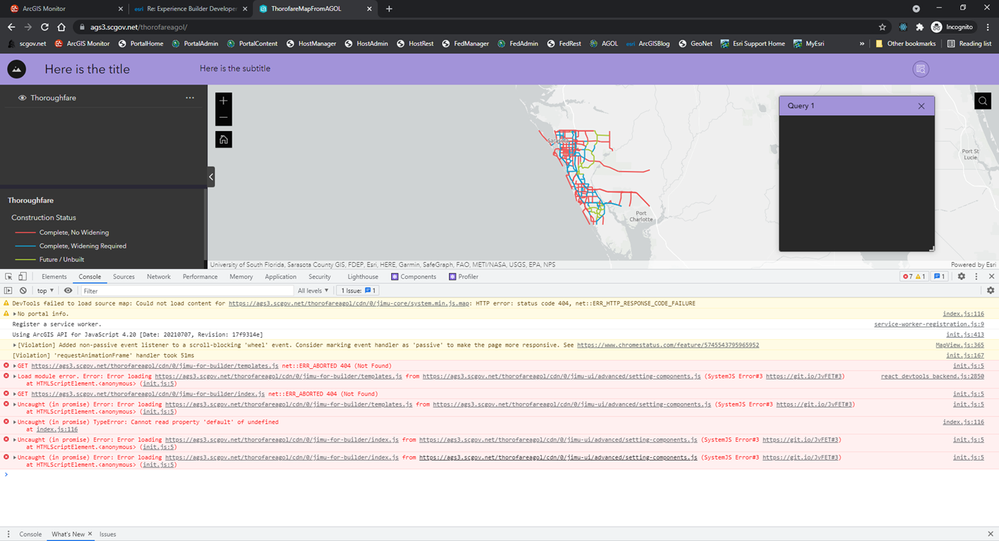

As a follow-up and as a test for whether or not anonymous access has an effect on this issue, I registered the 1.5 Exb with our ArcGIS Online organization.  I created a simple jewelry box theme app with one layer and one query.
As I noted earlier, while the data source is available to the map, mapview, layerlist and legend, the load fails for the Query Widget.  I am beginning to suspect an issue with the 1.5 version, as I receive the same load module errors. Maybe some of the modules are being compiled once I download the zip.  I don't know. Everything works in EB Dev, it only fails once deployed to my standard IIS webserver

However, when 'downloading' the published app to zip, unzipping it to our web server, the published / built app at https://ags3.scgov.net/thorofareagol (...\inetpub\wwwroot\thorofareagol\cdn\0) cannot access some of the libraries, and the query widget does not function:
So either the Dev Edition at 1.5 is not downloading / compiling the built app / query widget correctly, or I have another security issue with my web server or IIS.  To me, if the layer is available to the layer list widget, it should not have an issue with the query widget.
DavidColey
MVP Frequent Contributor
Yes @Junshan_Liu  that did it.  Thanks for the help on this, I would not have known to look there otherwise.
If I understand this correctly, I had the client/jimu-for-builder copied over to my deployment, not realizing that this folder essentially functions as the 'build-time' repository' ts files needed by the builder, whereas I suppose the client/dist/jimu-for-builder holds the 'runtime' js needed by the apps upon deployment.  My guess too is if a custom widget does not load to check this as well-
