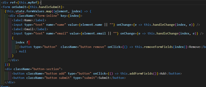

Good day! Try this out (pictures from a class, not function):
Set a state const for your responses = [];
Render the values using map index on the const:
{this.state.formValues.map((element, index) => (). This should be what you're looking for.

RyanDickinson1

RyanDickinson1
Sorry for the confusion, no difference. You will need to do the map and index on the rdata.
