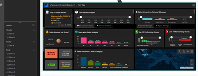

But, it seems like by using default features of experience builder, its not possible to make a link between dashboard and map/other components of builder. May be i am making is complicated. So, lets take example, that i have designed following dashboard shown in picture and now i am putting list component/filter component on builder. Because according to my knowledge, Embeded code has not any action and we can not apply any action on embed code component. So i found as, i can not do any filtering or communication on embeded code component. Please correct me if i am wrong!!

You can't translate actions made within an embed dashboart widget into actions that happen outside of it. However, your widgets (lists, map selections) can interact with the url used in the embed widget.
So you can interact with the dashboard from other widgets (throgh url filtering), but the embed widget cannot interact with other wigets. It's one way around.
