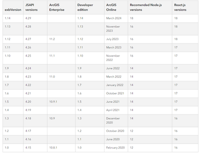

It's not really a bug. It's a feature your version of Enterprise does not have. ArcGIS Enterprise 10.9.1 has Experience Builder 1.5. ArcGIS Online has Experience Builder 1.14. Your version of Enterprise is nine updates behind. It looks like mailto links were added in Experience Builder 1.10. On Enterprise you will need 11.1 to get it.
https://developers.arcgis.com/experience-builder/guide/release-versions/

edward33
Didn't think something like MailTo: would be that far behind. Thanks for this table, its very useful
