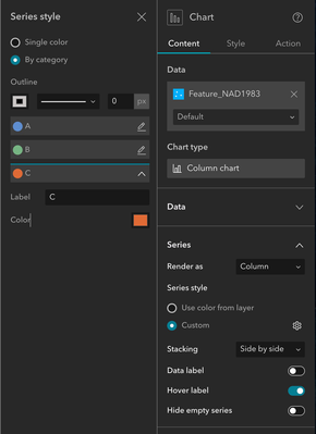

I'm still having the color issue. I'm in an enterprise environment, would that matter?
(sorry about the black - this isn't public data yet)
