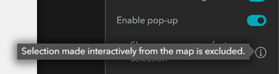

TonghuiMing
Hi @SummitMapping
There is a hint next to the mentioned option stating that the interactive selection of the map would not populate pop-ups, which is the current designed behavior:
TonghuiMing
Hi @SummitMapping
